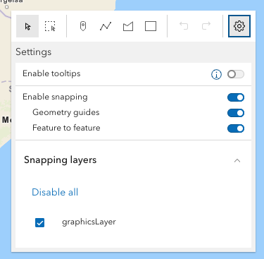

I'm trying to persist the settings as a User changes things like SnappingOptions:
Here's the gist of how I've attempted to do this:
