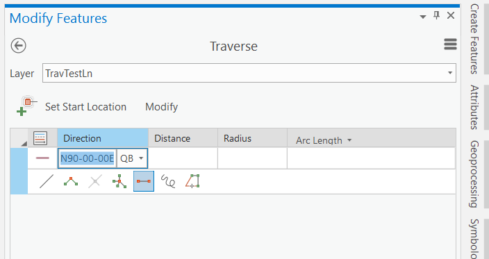

Hello Friends,
I am trying to build a functionality in a web application where a user can enter bearing, distance, radius etc. from a property deed and the tool should traverse a geometry using these provided measurement. This functionality is available in ArcGIS pro > COGO > Traverse tool
Some people have created a similar widget in WebApp builder here https://community.esri.com/t5/web-appbuilder-custom-widgets-documents/traverse-widget-2-5-11-14-2017... .
Could I achieve the same functionality using ArcGIS JavaScript Api?

Hello,
You may use pointFromDistance method for geodetic computations. You can also refer to the traverse widget to get some references.
