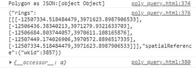

GisAdminCOG
Wow, this is exactly what I was looking for.   That JSON.stringify part gave me what I needed, the rings in a format I can use in the Imagery Download tool:
Thanks!!!
