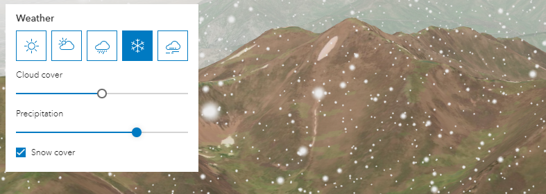

Does Weather->Snow Cover only apply to Local Scenes?
When I look at the weather widget in my global scene, Snow cover checked has no affect on the scene:

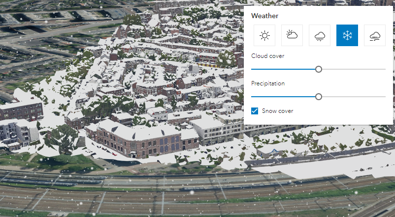

When I look at the JSAPI sample (https://developers.arcgis.com/javascript/latest/sample-code/scene-weather/) and I pan to the edge of the 3D buildings, I see that snow accumulation ends:
My questions are: What is the extent to which “Snow cover” actually functions? How can I enable it for my global scene? If I can not use it for my global scene, how can I hide or disable it.

Dear @Dirk_Vandervoort
Thanks for reaching out! So there a few things to note about the weather:
1. All weather effects are only available in global scenes, this includes the snowCover. So there is no snowCover in local scenes.
2. There are some limitations on the snowCover: It does not display on basemaps or draped layers (see here). This means the effect only takes place on 3D elements and integrated meshes like the one in your screenshot.
Currently it is also not possible yet to remove the checkbox in the widget. If this is something you would like to do, please let us know (ideally also with some infos on the use case). This way we can consider it for future releases.
