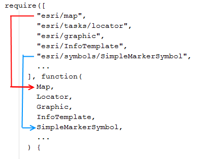

Take a look at this informative blog post on the basics of AMD programming.
The most important thing to remember is that the arguments are positional, which means that you have to be careful to ensure that your argument names are listed in the same order that you loaded your modules.  If this isn’t done your variables won’t refer to the module you expect them to.
