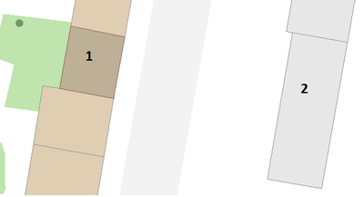

The data comes from one source table. If a string is entered in the penultimate column (1), everything works. If it is null, the object is displayed on the map, but no attributes can be retrieved from it. The problem affects many different layers - polygon and linear. It appeared when trying to switch from 4.24 to 4.28. Everything worked before.
We are using ArcGiS Server: 10.8.1 and a SQL Server database
For example: In this image below, I can click on building(1) and my popup will open, but if I click on building(2), nothing happens.
