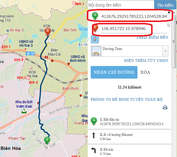

i used geododeService  in directions widgets, but My code did not work as I expected, when i clickMap to add a point to input parameter of directions widgets also adds at coordinates instead of address. How to adds Address to input directions widgets? thanKYou
