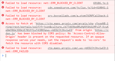

this is what I have and it seems to not work.
esriConfig.portalUrl = "https://ctq.maps.arcgis.com/arcgis"
Noah-Sager
That looks correct to me, but the error message in the console is about CORS. I would try testing the app in something like Codepen or another https location rather than from http from your localhost.

Hi @Noah-Sager ,
I get the same error in code pen. Is there a certain setting that I need to turn on/off to allow this?
Noah-Sager
Strange, it works for me with codepen and my org. I'm not sure if there is a setting to allow this, but I found this doc, maybe this will help?
https://doc.arcgis.com/en/arcgis-online/administer/configure-security.htm
