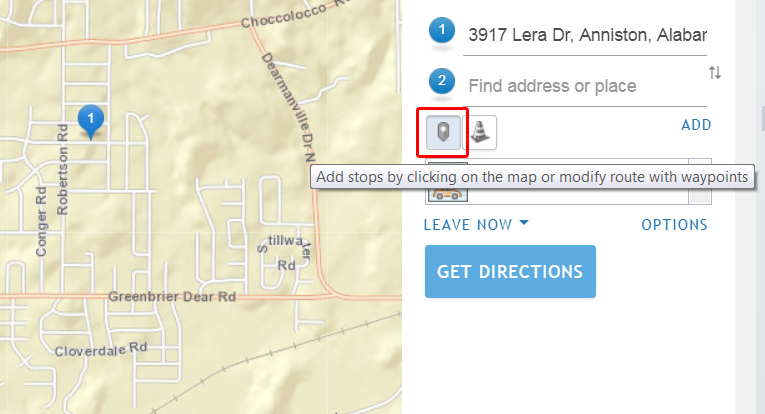

Is there a way to do a map click and record the XY in the To and From fields instead of entering an address or using the GPS locator?
  • Can I add parameters to the widget for XY To and From?
  • I can add a button to capture the XY into a variable but dont know if I can push that variable value to the To and From before running the widget
How do I clear the directions after the widget is run.  Looking for a clear all

Jay,
  Sure just click the button I outlined in the image:

I got the answer to my 2nd question....I used the parameter showClearButton
Still looking for the first question regarding adding XY from map click
RobertScheitlin__GISP
MVP Emeritus
Jay,
jaykapalczynski
Honored Contributor
Boy I feel stupid...thanks
