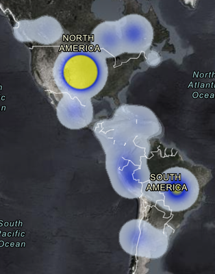

Also not quite right - the low end looks nice, but the high end looks blown out, like the heatmap is overflowing against an invisible square border.  Take a look - here is my goal:
Screen Shot 2020-12-26 at 9.10.04 PM.pngScreen Shot 2020-12-26 at 9.10.04 PM.png
But here is what I'm getting with the JS API:
Screen Shot 2020-12-26 at 9.10.00 PM.pngScreen Shot 2020-12-26 at 9.10.00 PM.png
I'm not sure why in my handcoded app, the heatmap looks "cut off"...if I can fix this, then the renderer from JSON will probably work just fine.  (And how to get that nice fade-out effect?)
