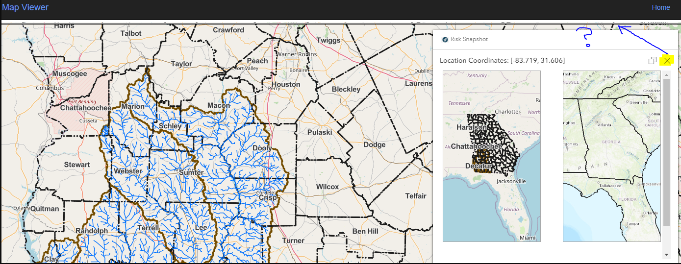

I have an esri popup in my web app MapView:

I also have a simple Bootstrap Navbar in my app:

For some reason, whenever, I close the popup, the navbar disappears. Any reason why this would happen or suggestions on how to fix it?
