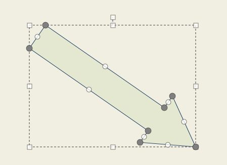

Here you can see I have drawn an arrow on the map and and activated the editor tool by clicking on the graphic.
I have a button to delete all graphics which invokes drawingGraphicsLayer.clear();
If that command is called while the editor tool is activated on the graphic the vertices remain on the screen.
