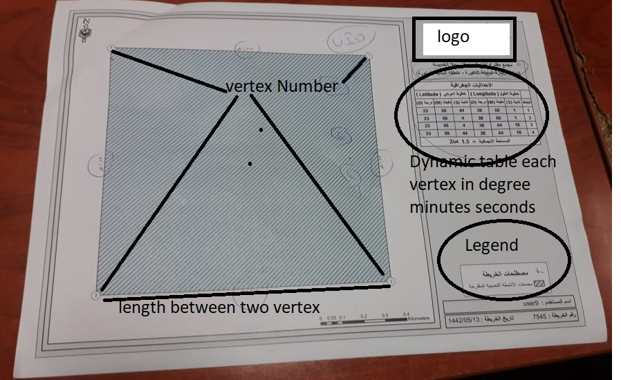

Dear All,
mu manager give me a task to create a report same like above pic.our data is consist of parcels.my manager want he can print each parcel in the above format.how it is possible.is there any information where should i start this.please help me to complete this task.
Thanks to all my friends

Hi @Nadir_Hussain, currently, there are tow options available to you for this sort of custom printing.
One, you can use the takeScreenshot() method if the elements are already visible in the app. Blog with tips here:
https://community.esri.com/t5/arcgis-configurable-apps-blogs/screenshots-with-the-arcgis-api-for-jav...
Two, you can publish a custom print template from ArcGIS Pro and publish that with the desired custom format and elements. Documentation is here:
https://enterprise.arcgis.com/en/server/latest/create-web-apps/windows/tutorial-publish-additional-l...
