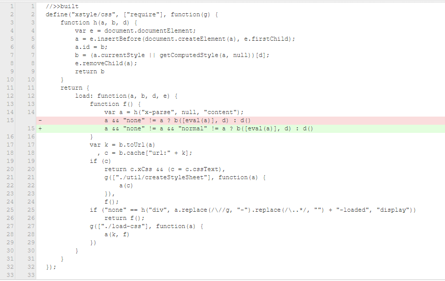

If it's the same issue, I ran into this one not too long ago with an application still using 3.14.  In this case, it's a problem in xstyle, which is included in the ArcGIS API for JavaScript.  For further reference, see this page.
The code shown on that linked page is slightly different than what I've found included with 3.14 though.  However, you can find the affected code in api\xstyle\css.js.  In that file, the fix I applied in 3.14 was to change the text:
a&&"none"!=a?b([eval(a)],d):d()
to
a&&"none"!=a&&"normal"!=a?b([eval(a)],d):d()
Basically, I just added a second condition to check that the value of "a" did not equal "normal".  Here's what a diff utility shows after formatting the before-and-after products:

JeremyMack_LU
Thanks, @JoelBennett. It looks like they've fixed the issue that you described. When I checked css.js it looked like this: k&&"none"!=k&&"normal"!=k?c([eval(k)]
JeremyMack_LU
@JoelBennett, I kept running with your suggestion and scraped the rest of the .js files associated with the app and found a file in js/dbootstrap called main.js that had the same xstyle definition. Adding the second condition fixed the issue. Many thanks!
