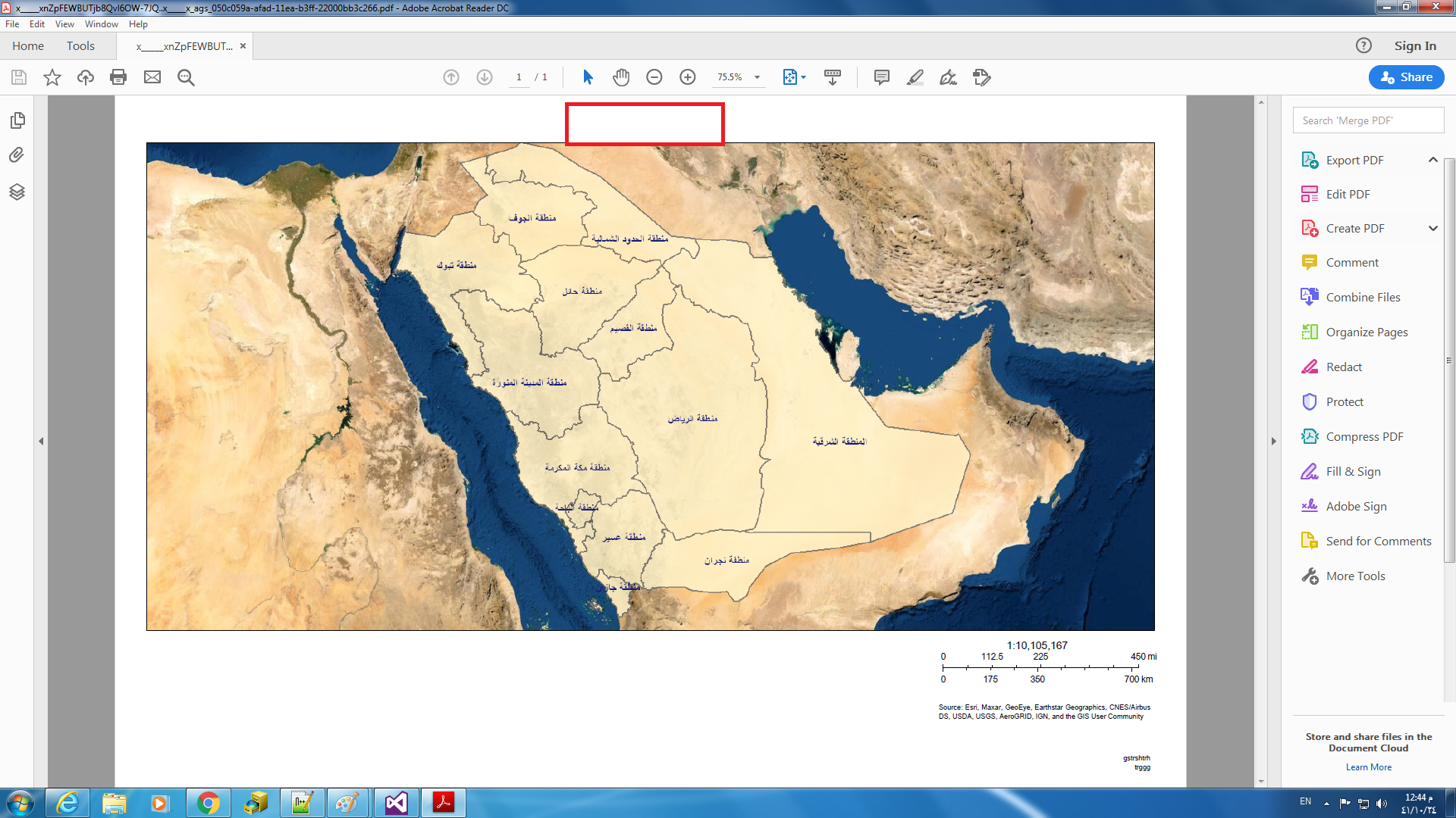

the below image i create from print task and it was in pdf format.Actually my manager want there should be our company logo on center above.where i place the red rectangle.it is possible to place company logo here.please help.i am using arcgis 4.15 java script api.

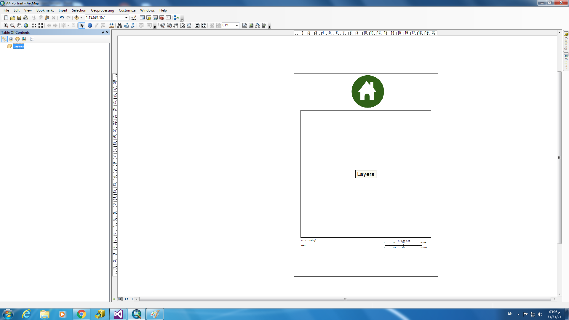

did you happen to have this 'Save Image as part of document' option checked for the picture element you insert in the arcmap layout?
6 Replies
TanuHoque
you need to publish print service with your own layout templates and you will need to author those templates with your company logo.
here is the help: Share custom layouts for printing from ArcGIS Pro—Documentation (10.7) | Documentation for ArcGIS En...

Three things to try/consider:
1) Check the Console tab of the browser and look for errors. Perhaps the image is 404ing. Also, if you look at the Network requests of the browser, can you find the execute request for the print task? I wonder if something useful is there.
2) Is the print service public? Can you share a link to it for testing?
3) Do you have ArcGIS Pro? I would recommend trying with Pro and see if the same behavior occurs.

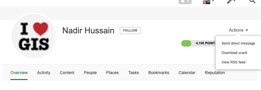

Also, for future reference, there is a way on GeoNet to send private/direct messages. If you are ever conversing with someone and want to share something non-publicly, just click on the person's profile and then click on Actions and select Send direct message, like this:
