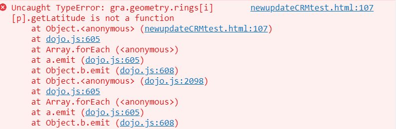

SiyabongaKubeka
Hi Robert,
When I use the suggestion above I get the following error saying that getLatitude and getLongitude are not functions.
