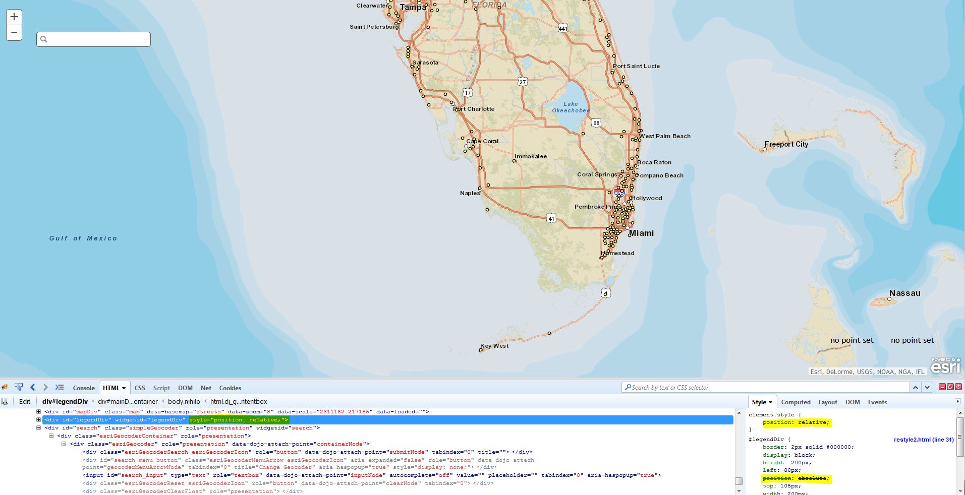

I couldn't reproduce your first issue with the square corners on your search div, but could reproduce the legend issue.  I'm not sure if this is a bug or not, but it appears something is changing the legendDiv CSS position property from 'absolute' to 'relative':
To work around this, you can add the legendDiv to a ContentPane and then apply your CSS to the ContentPane div.  Take a look at this JS Fiddle for an example.
