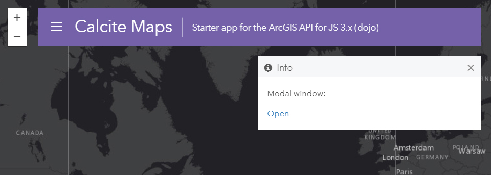

But you still can't open the modal window from the text link even though it is using the correct id:
<div class="panel-body">
  <p>Modal window:</p>
  <a href="#myModal">Open</a>
</div>
RobertScheitlin__GISP
MVP Emeritus
John,
   You can not just use an anchor element with an href to the modal popup id. You need the bootstrap data attributes to make it work:
<a href="" data-toggle="modal" data-target="#myModal">Open</a>
Don't forget to mark this question as answered by clicking on the "Correct Answer" link on the reply that answered your question.
