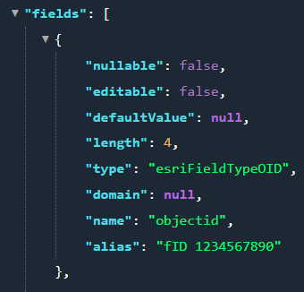

I get a success when I test this using Insomnia (like postman) but the data does not update with a visible attribute when I test with the following url
https://server.com/server/rest/services/Hosted/vms_1089_VMSData/FeatureServer/7?f=json&token=...toke....

2) The Field object within the SDK does not have a visible property, because it would have no meaning.  As far as a layer at runtime within the SDK is concerned, either a field exists or it doesn't.  It if exists, the information about it will be in the response sent by the server when the object requests information about the layer (e.g. as seen in the image you posted).  Otherwise, no information is provided to the client about fields that, in essence, don't exist.
