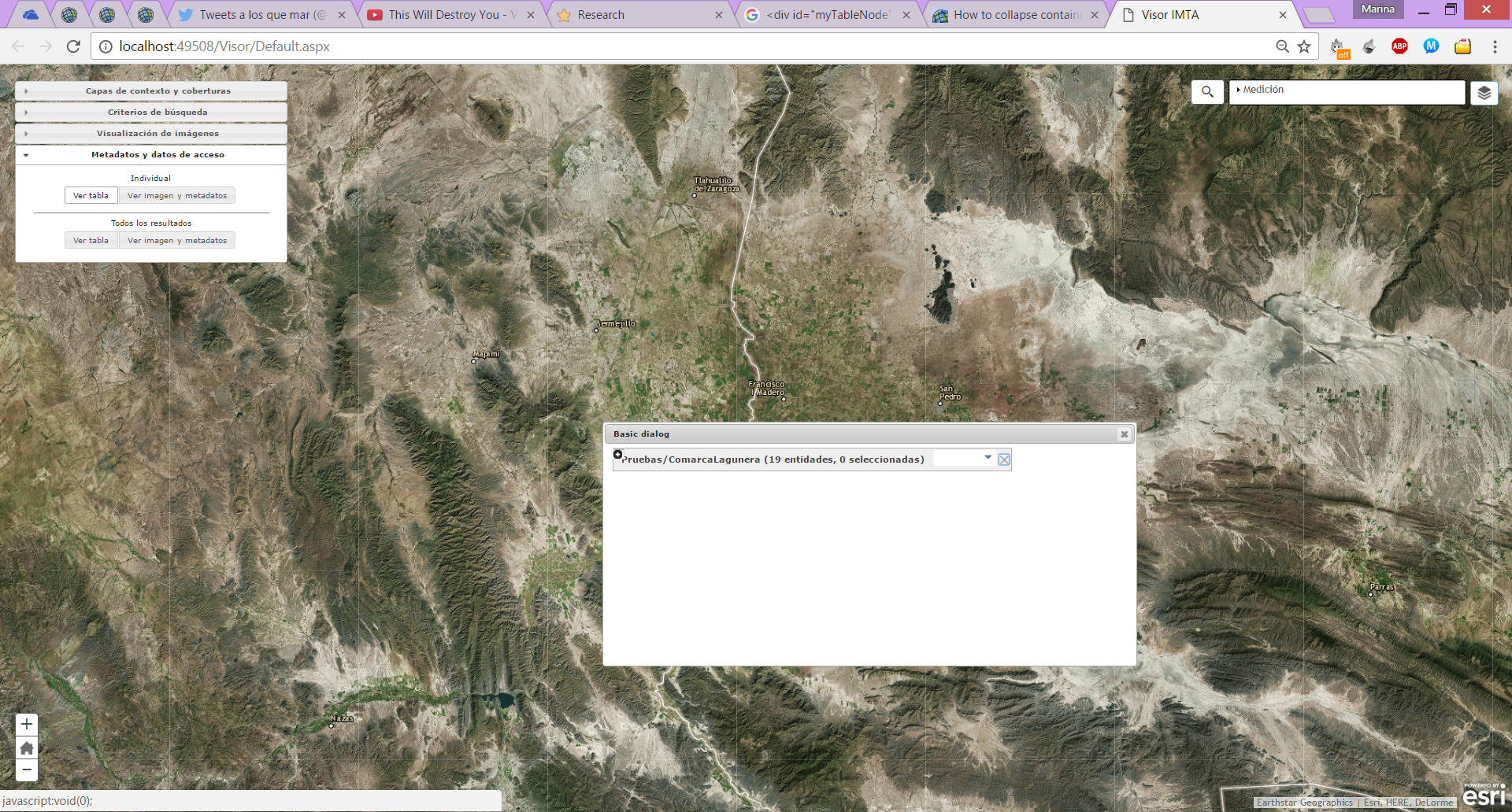

MarinaSánchez
Deactivated User
Hi, robert
Why does my table appear like this?
RobertScheitlin__GISP
MVP Emeritus
Marina,
   I would have to see your code but it looks like you have a css issue. Have you you added a link to your code for one of the dojo dijit theme (like claro)?
MarinaSánchez
Deactivated User
yes,
 <link rel="stylesheet" href="https://js.arcgis.com/3.16/dijit/themes/claro/claro.css">
the problem is because I dont use dojo's
<div id="dialog" title="Basic dialog" style="display:none">
   <div id="myTableNode"></div>
</div>
MVP Emeritus
Marina,
   If you take this sample in the sanbox and comment out the claro theme it looks a little like what you are seeing:
ArcGIS API for JavaScript Sandbox
So that leads me to believe that you FeatureTable is not getting the claro css rules.
