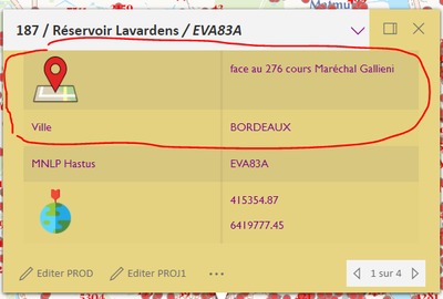

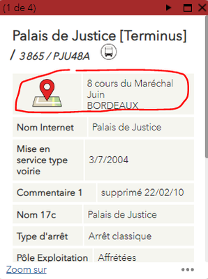

Hello,
I would like concatenate two attributes  in pop up. I 'd like to merge these attributes
like that
Thank you for your help!

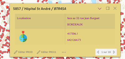

I found!!The arcade expressions have to be in the template properties and not out. With your function concatenate it works.
