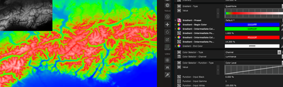

I am using the terrain elevation layer wich is black and white but I'd like to give it some color for more user friendly look.
For instance black to blue grey to green and white to red or more steps .. is there a built in library for this ?

@JohnGrayson well right now I'm gathering informations on how to do this so I have nothing to show. I just made a map with markers yet ...
@JohnGrayson thank you for your answer but , as I understand how blending work from photo editing , It could be part of the answer If I could blend only specific parts of the grayscale one at a time(black to red, gray to green and white to red), wich would also seem very coslty.
I want to end up with something like this
