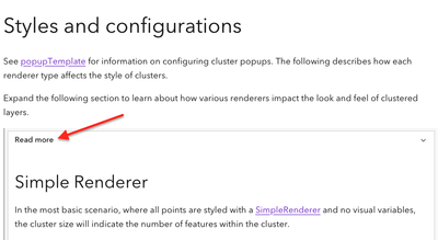

The color of a cluster is determined based on the style of the layer. If it is a unique value style, the color of the most common type within the cluster is used to shade the entire cluster. If a class breaks or continuous color visualization is used, then it is the color of the average value of features in that cluster. This behavior is described in the "Styles and configurations" part of the FeatureReductionCluster API reference: https://developers.arcgis.com/javascript/latest/api-reference/esri-layers-support-FeatureReductionCl...
Be sure to expand the "Read more" area to read the details:
