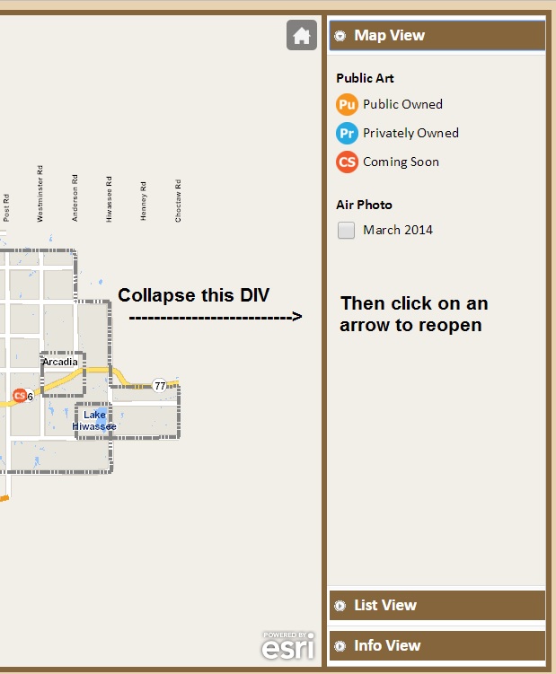

Hello Everyone!  I was wondering if anyone has developed an application where you have a DIV that contains a legend, then you have an arrow or button that collapses it within an application?
If so, how can this be done?
Example:
The result would be more map space:

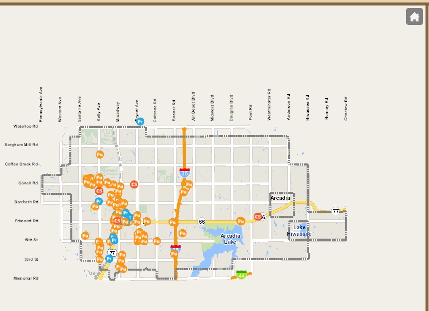

Any suggestions?  This will be the first time trying this out.  Thank you.
