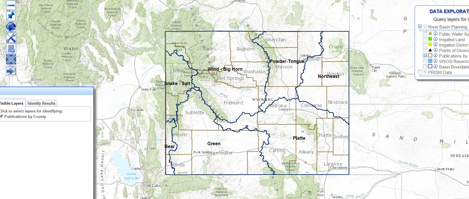

I have a table of contents that is used to toggle visibility of layers. I also have a dialog box that populates with the visible layers so that the user can pick from the visible layers what layer they would like to identify on. They use a checkbox to do this. However, when the map is panned or a feature is zoomed to the checkbox becomes unchecked.  here is a screen shot.
Here is the code i am using for creating the visible layer checkbox:
