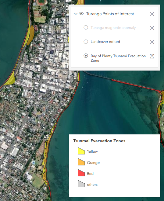

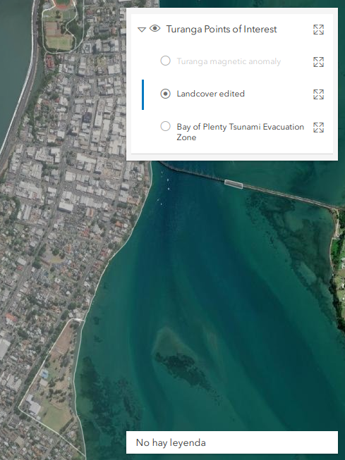

I'm currently trying to change the visible legend when a user selects one of three grouped layers to view. These can then be interacted with in a LayerList widget. Only one layer can be selected at a time, so the legend won't clash with any others. I've tried to look up for an event that runs on selecting a different layer via the LayerList, but haven't come across anything yet. Is this possible?
Code:
var groupLayer = new GroupLayer({
                    title: 'Tauranga Points of Interest',
                    visible: true,
                    visibilityMode: 'exclusive',
                    layers: [LAYERS_ADDED_IN_HERE],
                    opacity: 0.7
Images:
 Showing the first legend - all normal.Showing the first legend - all normal.
Other legends not showing on layer change. The legend is currently trying to display the same 'Tsunami Evacuation Zones' layer as before.Other legends not showing on layer change. The legend is currently trying to display the same 'Tsunami Evacuation Zones' layer as before.

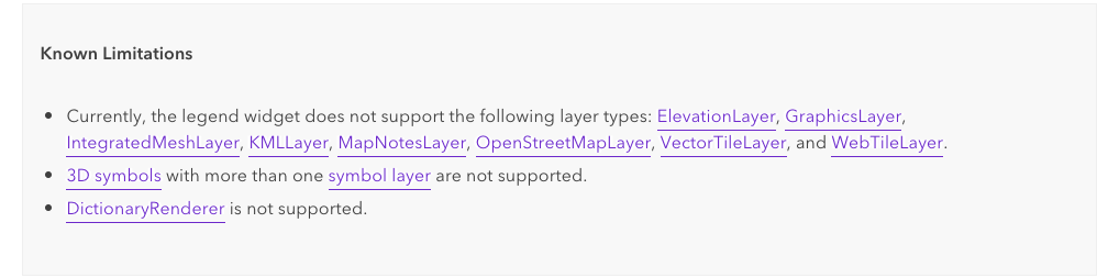

It should work. Perhaps you are adding one of layer types that is not supported in the Legend widget? You can see the list of unsupported layers from the sdk doc.
