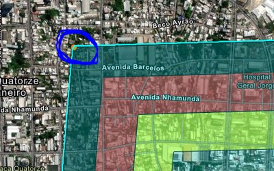

Hello everyone. I want to change the size of the vertex circle symbol when sketch is in update mode. It have to be bigger because is tiny to user see.

EduardoBorges
This solution dont't work for me...
EduardoBorges
This approach worked for me, but when a move the cursor above the vertex symbol, return to the previous behaviour.
