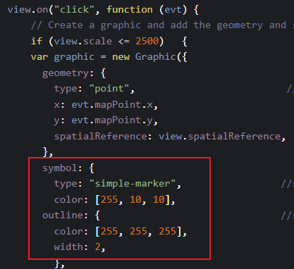

Currently if a customer clicks on the map it drops a simple marker symbol (in red):
The code is:

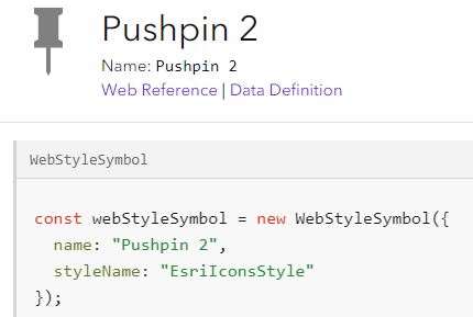

I'd like to change the symbol to a pushpin and I've found the following on the ArcGIS API for Javascript site:
https://developers.arcgis.com/javascript/latest/visualization/symbols-color-ramps/esri-web-style-sym...
The web reference behind the link is:
{"name":"Pushpin 2","type":"PointSymbol3D","symbolLayers":[{"type":"Icon","size":20,"anchor":"bottom","material":{"color":[232,157,0],"transparency":0},"resource":{"href":"https://static.arcgis.com/arcgis/styleItems/Icons/web/resource/Pushpin2.svg"}}]}

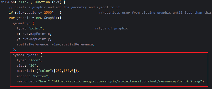

 I've tried putting this into my code:
But it's not working. Do I need to put the WebStyleSymbol syntax somewhere in my code or have I updated the current symbol code incorrectly?

ReneRubalcava
Esri Frequent Contributor
That link is for the 3D SymbolStyles, you want to use the 2D symbol styles
const webStyleSymbol = new WebStyleSymbol({
  styleName: "Esri2DPointSymbolsStyle"
If you want to tweak it a bit, each 2D Web Style Symbol is also available as a CIM Symbol and you can modify the symbology a bit as you need. There's a tab to select the CIM JSON.

where would I put the web style symbol in my code? Guessing I'd need to edit it in here somewhere?
 view.on("click", function (evt) {
          if (view.scale <= 3500)
          var graphic = new Graphic({
            geometry: {
              type: "point",
              x: evt.mapPoint.x,
              y: evt.mapPoint.y,
              spatialReference: view.spatialReference,
            symbol: {
              type: "simple-marker",
              color: [255, 10, 10],
            outline: {
              color: [255, 255, 255],
              width: 2,
          view.graphics.removeAll();
          view.graphics.add(graphic);
Thanks
