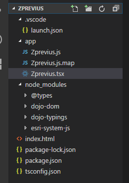

I am doing a personalized Widget. I configured all the folder and files related to the widget as is shown in this image:
My Zprevious Widget
.. but I have a problem finding the dojo/dom library using this code line:

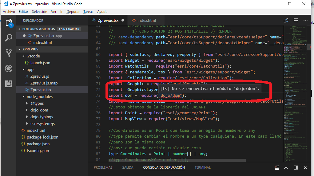

import dom = require("dojo/dom");
The error messagge in the visual studio code window is: Cannot find module 'dojo/dom'
dojo/dom cannot find module
I used npm to aditionally install dojo/dom and its typings, but I cannot fix the accees to the library.
