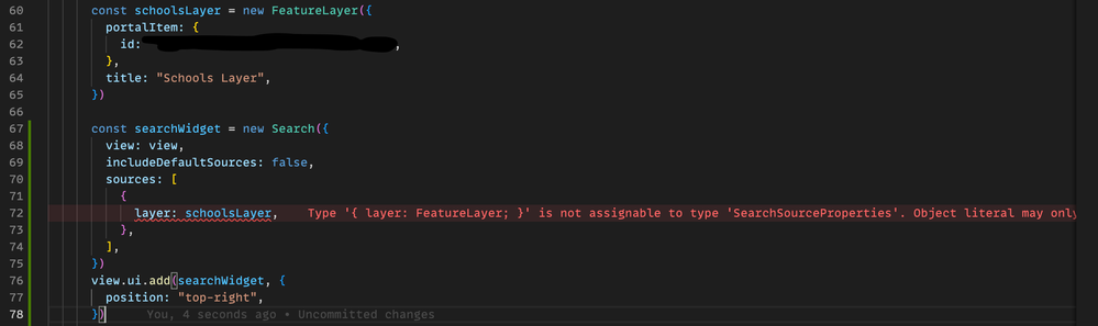

I try to follow the doc to add a layer as custom source for the Search widget: https://developers.arcgis.com/javascript/latest/api-reference/esri-widgets-Search.html#sources
But I get:
The full error is -
Type '{ layer: FeatureLayer; }' is not assignable to type 'SearchSourceProperties'.
Object literal may only specify known properties, and 'layer' does not exist in type 'SearchSourceProperties'.
ts(2322)
How should I add a  FeatureLayer as source to the Search widget? I am using 4.25.5 ES module version.

That is a TypeScript typing issue. TypeScript doesn't type autocasted properties, so you need to instantiate it as an instance of the SearchSource.
https://developers.arcgis.com/javascript/latest/api-reference/esri-widgets-Search-SearchSource.html
sources: [new SearchSource({ layer, ...otherstuff })]
Might need to instantiate some other stuff to make TypeScript happy.

This sample shows how to use the layer as a search source. There are other options you need to set, like what fields to search and stuff.
https://developers.arcgis.com/javascript/latest/sample-code/widgets-search-multiplesource/

noah
Thanks. But would you show me some code for a working JavaScript version? The code compiled regardlessly but the search did not show me any result from the layer.
