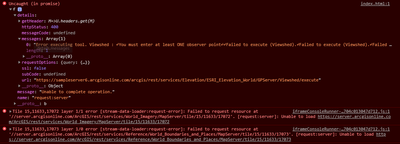

Also, sometimes when you click to create a viewshed, an uncaught promise is thrown. You can replicate this by clicking anywhere on the north pole or by just randomly clicking. How can I fix this?

I was also getting those random uncaught promise errors. The north pole is understandable because the elevation layers don't cover that area - from the Viewshed page on ArcGIS Online:
By default, this tool currently works worldwide between 60 degrees north and 56 degrees south based on the 3 arc-second (approximately 90 meter) resolution SRTM dataset.
However I was also getting errors just clicking around and don't know why.

But do you happen to know why an uncaught promise is sometimes thrown in the sample? Clicking the north pole is understandable, as Tim explained. But why is it being thrown when clicking on valid locations?
JohnGrayson
Esri Alum
The error says you're trying to call the service with no observer locations passed in, so the first thing to check is to make sure there's at least  one valid observer location before making the call.  Hard to tell otherwise unless we have a reproducible use-case.  My guess is that the there's no logic in the code to pause the interaction while there's processing going on and maybe that could be an issue, but just a guess as I haven't run into the situation described.
