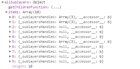

I'm trying to hit the properties of the sublayers in a map image service using the "allSublayers" property of that service. It works fine in the console in Chrome:
 allSublayers output

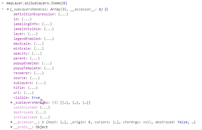

I can hit each of these items and access the properties of each:
allSublayers index

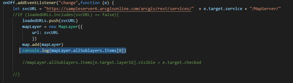

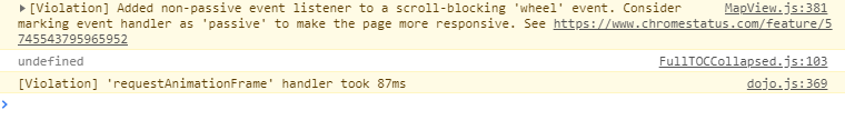

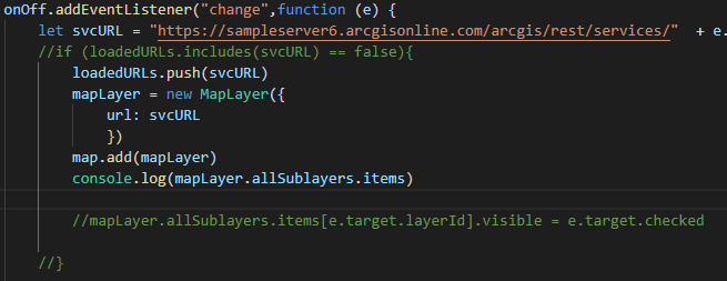

Here's another example to illustrate the issue. In the first image, you'll see that I am logging the first index of the allSubLayers array, then the array itself (the highlighted lines). The second image shows what is returned. The browser interprets the selected index as null, whereas it finds the array fine. If you duplicate those console.log commands (third image) in the browser console itself, everything works great and it returns "true" for the visibility of index 0.
I think this is a fundamental javascript array functionality issue that none of the video tutorials I've watched have covered .
Any ideas?
