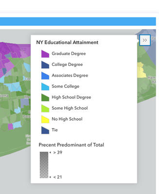

I have a problem where my popovers, calcite dropdowns and such all don't quite line up.
It could be to do with how my web app is laid out. I'm unsure which part would trigger this.
This problem only occurs on Chromium based browsers. Firefox is fine.
ChromeChromeFirefoxFirefox

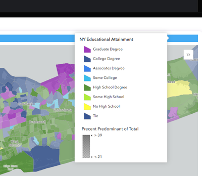

Hello @kaleb_integralNZ ,
Here is a fix: https://codepen.io/driskull/pen/eYqveRg
arcgis-map {
  height: 100%;
  container-type: inline-size;
  contain: layout;
Here is some more information on why this is needed:
https://dev.to/michaelcharles/chrome-129s-container-query-change-2i77
https://issues.chromium.org/issues/369781727?pli=1
Let me know if that solves it for you.

kaleb_integralNZ
Thanks for the solution!
