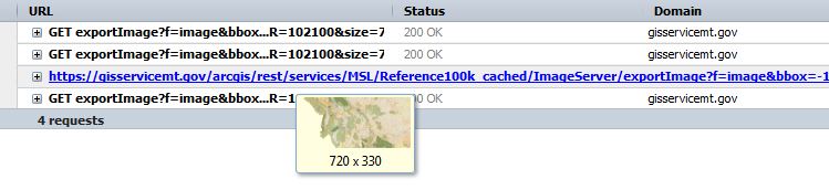

I am attempting to load a cached Image Service into a basemap gallery.  The image service does work, but it is behaving like a dynamic image service, not a cached one.  By that, I mean that it is running a export image request each time the map pans instead of fetching the pregenerated tiles.
Here is a link to the service: https://gisservicemt.gov/arcgis/rest/services/MSL/Reference100k_cached/ImageServer
Here is the link to a jsFiddle demonstrating a basemap gallery with one tiled map service and one tiled image service.
https://jsfiddle.net/bdaigle/22Lgp45f/
If you watch the network traffic, you will see that the two basemaps handle the request very differently -- the tiled map service fetches map tiles, whereas the tile image service runs an exportImage task.
The service does behave like a cached service if I explicitly define it as a ArcGISTiledMapServiceLayer and load it to the map manually (without the use of the Basemap Gallery), so I believe this is an issue with the BasemapGallery itself.

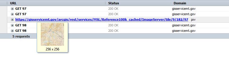

BillDaigle
I'm working in firefox with firebug, but the network tab in Chrome will give you similar results.
Here is what the calls look when the layer is loaded to the basemapGallery.
Here is what they look like when they are loaded as a regular Tiled Layer:

BillDaigle
That looks like a dynamic map service request to me as well.  Here is how they should behave:
  • Dynamic map service: When you pan the map, you should see a single map service request for the current map extent
  • Tile map service:  When you pan the map, you should see zero or more tiles fetched for the given extent.  If you already have the tiles cached locally, zero tiles will be returned.  If not, one or more tiles will get returned.
