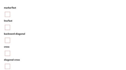

For simple fills, for anything other than `solid` types, the preview doesn't render anything, and in the console, the arcgis internal "previewSymbol2D.js" throws an error against ".toCss is not a function".
Relevant Codepen, testing on the `/next/` version (also tested against 4.24):
https://codepen.io/Tickthokk/pen/oNdwoEv
It'd be great to render polygons that are not solid!
Thank you 🙂
AnneFitz
Hi @NicholasWright - this works as expected if you use the SimpleFillSymbol constructor instead of autocasting. Here's an updated version of your example: https://codepen.io/annefitz/pen/yLjXvgO
