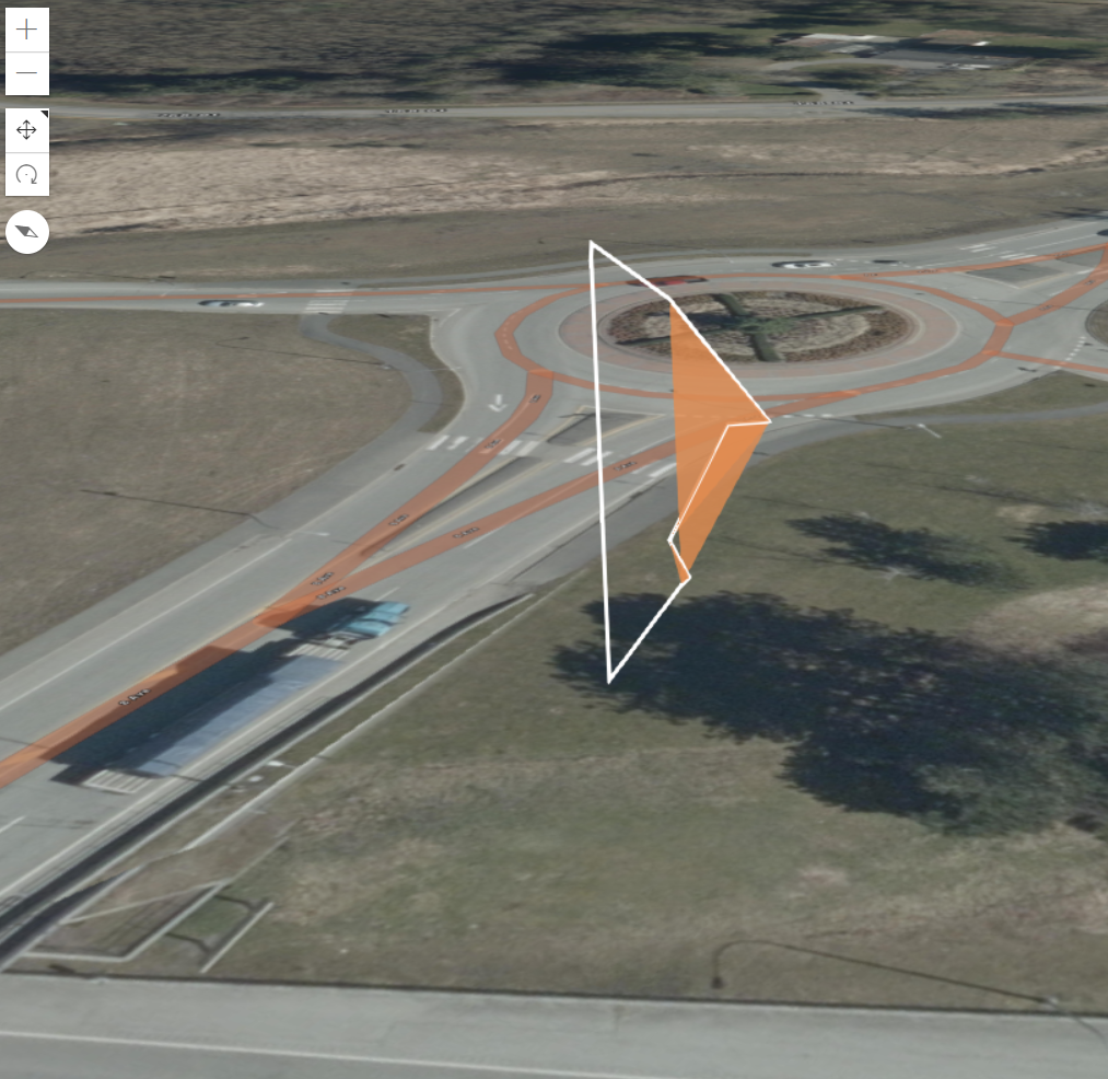

the following polygon fill renders incorrectly (the polygon is oriented vertically)

VeronikaLanders
Unfortunately, this is a current limitation and in our backlog.
Could you please elaborate what you are trying to show with this specific polygon and explain the use case behind? This helps us to prioritize since solving all possible cases is not trivial in 3D.
Thanks a lot for your insights,
Veronika
BerwynMcKilligan
I am using this to show geotechnical sounding information, displaying measured properties with depth and defining layers at depth, the following example is elevated above the surface for clarity.
or bellow ground
images are rendered using cesium, looking to implement ArcGIS js
GreteSoosalu
Hi @BerwynMcKilligan
We've installed a fix for this in the upcoming 4.28 release that goes out this October.
Once you can try it out, let us know if you still run into any issues!
