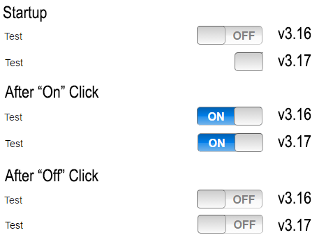

I recently switch my web site from  js.arcgis.com/3.16 to js.arcgis.com/3.17 and noticed that all of my dojox.mobile.Switch elements were displaying incorrectly on the iPhone. This is how it looks:
Code for dojox.mobile.Switch on iPhone in v3.17 when displaying incorrectly:
<div class="mblSwitchInner" style="left: 0px;">...</div>
Code for dojox.mobile.Switch on iPhone in v3.16 when displaying correctly:
<div class="mblSwitchInner" style="left: -53px;">...</div>
Code on all other the devices in v3.16 and v3.17 where the switch appears correctly:
Is this a bug?
Tags (2)
KadeSmith
One more piece of information. Just out of curiosity I changed my version to 3.18 and it rendered correctly.
