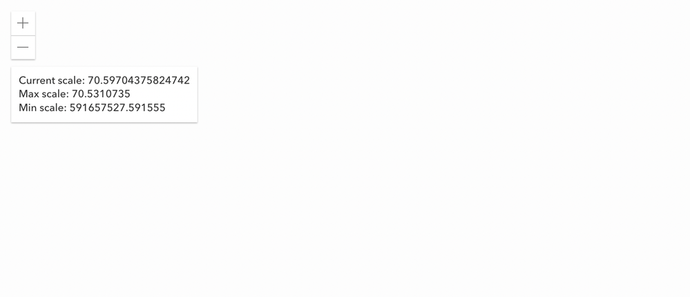

I'd like to report the bug again. There is a bug with continuous zoom (view.constraints.snapToZoom = false). It's sometimes impossible to zoom in to max scale (or zoom out to min scale) using mouse wheel.
Look at the screenshot below (I zoomed in using mouse wheel and i can't go further with mouse wheel. The only way to achieve max scale is to use '+' button).Screenshot 2023-07-20 at 10.22.12.png
Codepen: https://codepen.io/matiol/pen/PoxamWL

If this behavior is by design, then it likely won't be classified as a bug, which might explain why you didn't get any traction last time.  Fortunately, working around this is easy.  Below is the code from the script tag in your codepen, with lines 28 - 34 added in order to provide the behavior you're looking for.
      require([
      "esri/Map",
      "esri/views/MapView",
    ], function(
      Map,
      MapView,
      Expand
      const map = new Map({
        basemap: 'topo'
      // center the view over 48 states
      const view = new MapView({
        container: "viewDiv",
        map: map,
        center: [-100, 35],
        zoom: 19,
        constraints: {
          snapToZoom: false
      view.ui.add("scaleDiv", "top-left");
      const scaleDiv = document.getElementById("scaleDiv");
      view.watch('stationary', () => {
            document.getElementById("scaleDiv").innerHTML = `Current scale: ${view.scale}<br> Max scale: ${view.constraints.effectiveMaxScale} <br> Min scale: ${view.constraints.effectiveMinScale}`;
      view.on("mouse-wheel", function(evt) {
        var viewScale = view.scale;
        window.setTimeout(function() {
          if ((viewScale == view.scale) && (viewScale != view.constraints.effectiveMinScale) && (viewScale != view.constraints.effectiveMaxScale))
            view.scale = ((evt.deltaY > 0) ? view.constraints.effectiveMinScale : view.constraints.effectiveMaxScale);
        }, 10);
Note that the mouse-wheel event occurs before the setting of the view's scale value.  As a result, when the mouse-wheel event fires, the view's scale property is still set to the value it had before the mouse wheel was moved.  The window.setTimeout call is used to work around that sequence.
