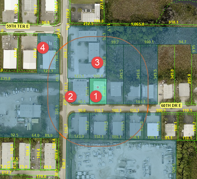

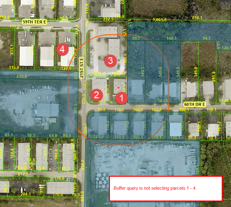

I'll follow this post up with more details and a jsbin, but right now I was wondering if there is something obvious with this issue and what I can do to troubleshoot it further. I have a layerView query that executes on a buffer. Sometimes, maybe 40% of the time, the query results excludes a few of the buffered parcels by not adding its graphic (as shown in image A), other times the parcel is completely excluded from the query results. My next troubleshooting is to perform the query directly in ArcGIS execute form and try to reproduce the results I'm seeing here.
image A
image B
The basic workflow here is to query geometry with a buffer size and units (like feet), then add graphics to view and update a table with the results of the query.

GregoryBologna
Update to this issue. I have identified the reason why some buffered parcels are not selected. The layerView.features.length is zero. Finding this info,
https://developers.arcgis.com/javascript/latest/api-reference/esri-rest-support-Query.html#returnGeo...
If true, the query geometry will be returned with the query results. It is useful for getting the buffer geometry generated when querying features by distance or getting the query geometry projected in the outSpatialReference of the query. The query geometry is returned only for client-side queries and hosted feature services and if the layer's capabilities.query.supportsQueryGeometry is true.
Setting returnQueryGeometry = true so far appears to resolve this issue.
