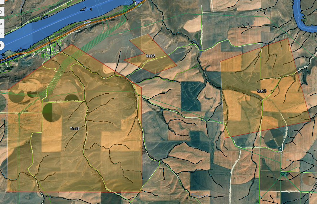

Using the JS Maps SDK 4.31 with the boundaryOperator Geometry Operator within an Experience Builder custom widget.  When I pass in a polygon geometry the paths on the output Polyline don't close.  The last point in the path isn't the same as the first point like the rings in the Polygon.
These are the rings in the polygon were the first vertex is identical to the last vertex.
These are the paths on the boundaryOperator output Polyline were the lastPoint is not identical to the first Point.
My two workarounds are to either A) generate a Polyline with paths from the Polygon rings, or B) Push the firstPoint from the Polyline paths onto the end of the Polyline paths array.  The boundaryOperator seems to be behaving like this every time regardless of the zoom level or shape of the polygon.
