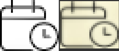

Hi @AnN , i'm using the latest JS. Whilst i cant provide a repo, I can show an image to explain.
The image on left is an SVG rendered normally, whilst the right is rendered as a graphic on the canvas.
Note the height is 2px smaller, and the paths/lines are fuzzy (aka blurry) and not crisp.. which i'm attributing to the 'anti-aliasing' being applied?
This svg is composed of 4 lines: 2 horizontal, 2 vertical, forming a "box/square", but is rendered like this.
Obviously the browser needs to sub-sample when path/lines/rect etc are using decimals. Canvas element rendering can be controlled through
image-rendering: pixelated; image-rendering: crisp-edges;
so how does one do same for ArcGIS JS 'picture-marker' graphic objects?

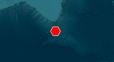

Was there a solution to this problem? I'm on the latest javascript SDKs and my svgs are render blurry. The height and width match what is set in the SVG itself, but it's blurry.
<svg width="14" height="14" viewBox="0 0 14 14" fill="none" xmlns="http://www.w3.org/2000/svg">
<path d="M0.707639 6.50388C0.531958 6.81132 0.531958 7.18874 0.70764 7.49618L3.42192 12.2461C3.59996 12.5576 3.9313 12.7499 4.29016 12.7499H9.70984C10.0687 12.7499 10.4 12.5576 10.5781 12.2461L13.2924 7.49618C13.468 7.18874 13.468 6.81132 13.2924 6.50388L10.5781 1.75398C10.4 1.4424 10.0687 1.25012 9.70984 1.25012H4.29016C3.9313 1.25012 3.59996 1.44241 3.42192 1.75398L0.707639 6.50388Z" fill="#E52A2D" stroke="white"/>
</svg>
Here's an example: https://codepen.io/annefitz/pen/poQYvwJ?editors=1000

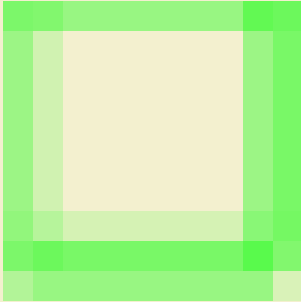

Unfortunately I can't save code pens at work, but I'm pulling in the SVG as a file, not a path for a simple marker. We have some complex svgs we'd like to use and can't just paste in one path. The blur is subtle, but noticable. In the attached picture the green is made using a simple marker, the red is with a file path to an actual svg image.
            const markerSymbol = {
                type: 'simple-marker',
                path: 'M11.2022 0.909049L11.0265 0.733313H10.7779H5.22238H4.97386L4.79812 0.909049L0.909232 4.79794L0.733496 4.97367V5.2222V10.7778V11.0263L0.909232 11.202L4.79812 15.0909L4.97386 15.2666H5.22238H10.7779H11.0265L11.2022 15.0909L15.0911 11.202L15.2668 11.0263V10.7778V5.2222V4.97367L15.0911 4.79794L11.2022 0.909049Z',
                color: 'red',
                outline: {
                    type: 'simple-line',
                    color: 'white',
                    width: 1.2
            const svgStopSign = {
                type: 'picture-marker',
                url: '/path/to/file.svg,
                height: 14,
                width: 14
<svg xmlns="http://www.w3.org/2000/svg" width="32" height="32" viewBox="0 0 32 32" fill="none">
    <path d="M22.2625 1.95958L21.9696 1.66669H21.5554H10.4443H10.0301L9.73717 1.95958L1.9594 9.73736L1.6665 10.0303V10.4445V21.5556V21.9698L1.9594 22.2627L9.73717 30.0405L10.0301 30.3334H10.4443H21.5554H21.9696L22.2625 30.0405L30.0403 22.2627L30.3332 21.9698V21.5556V10.4445V10.0303L30.0403 9.73736L22.2625 1.95958Z" fill="#E52A2D" stroke="white" stroke-width="2"/>
</svg>

Thanks for the additional info @AndrewTaylor0942 ! I can see there is some blurriness -- we will take a look!
In the meantime, you can try converting your complex SVGs to CIM symbols using the CIM Symbol Builder. Here's a blog that walks you through how to do this: https://www.esri.com/arcgis-blog/products/js-api-arcgis/developers/upload-symbols-from-svg-in-the-up...
Let me know if that works for you or if you have any questions! 🙂
AnneFitz
We've installed a fix for the blurriness that will be released at version 4.28. You can test it out on our development version of the API, https://js.arcgis.com/next. Please let us know if you are still running into issues!
