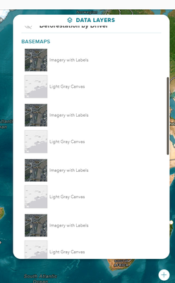

Hello,
I have a React 17 app utilizing 4.21 of the JS Maps SDK.  I am able to add the BasemapGallery widget with two basemaps, but the basemap tiles are duplicated 14 times.  Is there a hook I should be using to prevent the duplication?
Also, how can I force the gallery to display as 3 horizontal tiles per row, instead of just vertically?
Thanks!!

bradMaps
useEffect/useRef fixed it!
For anyone interested, here's the new code:

Any tips on forcing the gallery to display as 3 horizontal tiles per row, instead of just vertically?  It seems that if the width is > 450px, it should show as 3 tiles per row.
Thanks again!

Tough to tell from snippet, if you have a git repo or stackblitz, might be able to tell.
You probably don't want to assign the BasemapGallery container directly, do it in a useEffect with a useRef with some guards against nulls and stuff.
Does this happen in dev mode and prod? HMR can do this sometimes.

Thanks for taking a look.  Unfortunately, the code is private, so I can't share the repo.  I will look into creating a stackblitz if I'm still stuck after trying your suggestions.  I just ran a build and it is still showing the basemaps repeated, so I don't think HMR is the culprit.
