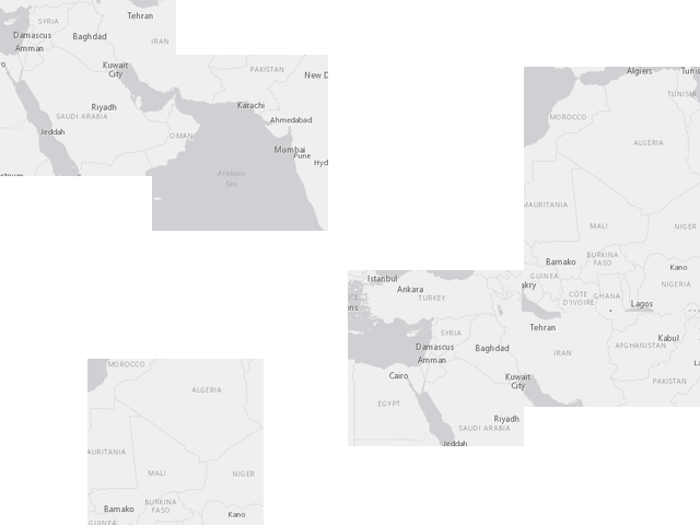

Hi all, I'm working within a corporate environment that is using ArcGIS Server (v10.2.2). I am a newbie trying to work with ArcGIS API for Javascript (v3.9) to create custom map applications. I can't seem to get a basic map up and running. For example, when I write this code:

I get the basemap map tiles all disjointed like so (re-created in Photoshop for illustration purposes😞
Is it possible that the coordinates are wrong? Our server is using ArcGIS with 4326(WGS84). Again, I am an extreme newbie, so I am not sure I am using the correct language here. Thanks for any tips and advice on how to troubleshoot this.

Nick,
It looks to me like you have a bad path to the css. If you update the css path to the version used in 3.9 instead of 3.11 everything should work (just add /js after you change 3.11 to 3.9).
