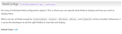

The purpose of the FeatureTable I am building is to display unedited data from a public source. According to the documentation, leaving the fieldConfigs blank will autocast all of the fields which is exactly the behavior I want.

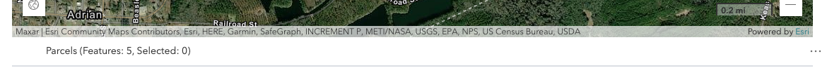

And all I'm getting is the table header:
How can I get the columns to Autocast?
JeffreyThompson1
Apparently, this was a CSS issue. The data was being autocast correctly, but put into a div with 0px height.
I was able to solve the problem by adding this to my CSS file.
.esri-feature-table__content {
	min-height: 200px !important;

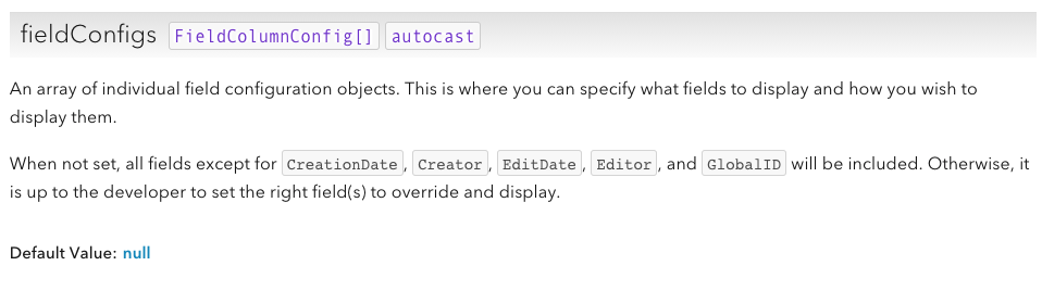

Autocast means you don't need to new up an instance of the FieldColumnConfig, just pass an object that has the constructor properties.
https://developers.arcgis.com/javascript/latest/programming-patterns/#autocasting
Does your layer have fields other than the ones it says will not be included automatically?
