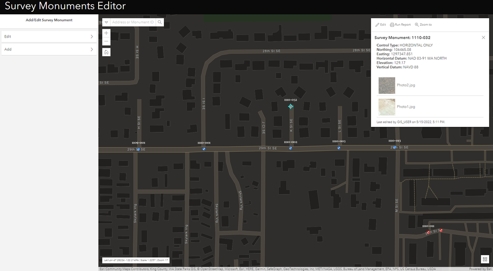

I know this is pretty old at this point, but I had run into the same issue using 4.21 and wanted to share what I found for those who happen to run across this.
In my case, I needed to update the supportsResizeAttachments property to true once the layer was loaded. This property is actually not read only. I had originally thought the same thing as the documentation suggests that it is.
featureLayer.load().then(() => {
    featureLayer.capabilities.operations.supportsResizeAttachments = true;

I'm working with a Feature Service served up from ArcGIS Server 10.8.1. ArcGIS JS API 4.22 and my popup is using the AttachmentContent popup element.
In my case, I needed to update the supportsResizeAttachments property to true on the Feature Layer once it was loaded. As far as I know there is nothing that needs to change on the Feature Service/ Map Service end.
