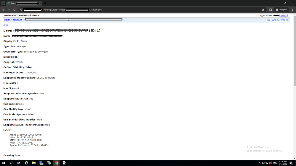

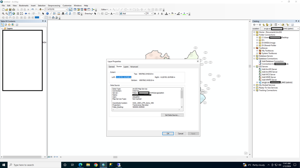

MamoonRasheed
@TanuHoque ,
I already tested with both use cases (Through Browser and ArcGISPro). Errors or messages have not been promoted. map services displayed correctly. Two (02) images are attached herewith for your kind reference.
AccessingMapServiceThroughBrowserAccessingMapServiceThroughBrowserAccessing MapServiceThroughProAccessing MapServiceThroughPro

Also, from your screenshots it looks like your map service is secured. If so, are tokens being included in print service requests? are they getting generated using your local ip/local host or your machine/domain url?
