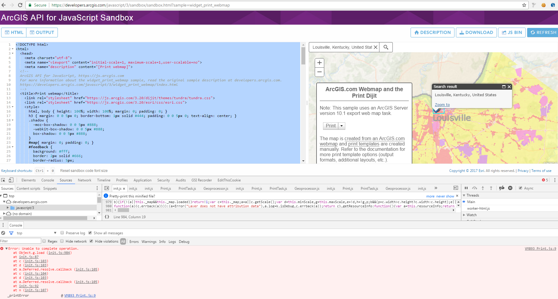

ArcGIS JSAPI Print Issue: Error executing tool.: Layer "map_graphics": ᧖ Failed to execute (Export Web Map). Failed to execute (Export Web Map Task)
4226
04-25-2017 10:37 AM
ChrisSmith7
Honored Contributor
This issue came-up after resolving an IIS validation issue described here - ArcGIS JSAPI Print/Validation Issue: SyntaxError: Unexpected token <
It seems similar to an issue reported awhile back here - Print Task fails with default Selected Point Graphic
To replicate the issue, because a proxy is involved (and I wasn't able to hit the Esri proxy outside of an Esri domain), you'll have to use sandbox and manually paste code:
ArcGIS API for JavaScript Sandbox
1) Copy the following code:

2) Paste into the print widget sandbox example
3) Click "refresh" in the sandbox window
4) Print the page (PDF) without searching an address, which is successful
-> Notice the following URL is hit in Fiddler (non proxy) -https://sampleserver6.arcgisonline.com/arcgis/rest/services/Utilities/PrintingTools/GPServer/Export...

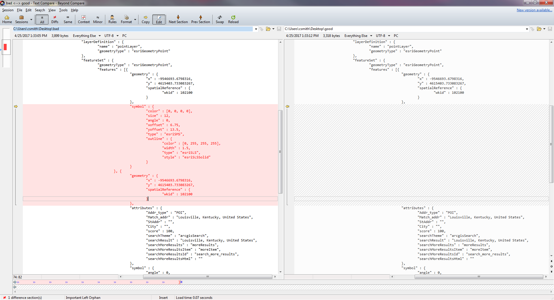

-> Here's the JSON sent:

5) Click "refresh" in the sandbox to reload
6) In the Search widget:
-> "Louisville, Kentucky, United States"
-> Search
7) Allow the geocode/plot process to complete (don't close anything)
😎 Print the page (PDF) after searching, which is not successful
-> Notice the following URL is hit in Fiddler (proxy) - https://developers.arcgis.com/proxy/?https://sampleserver6.arcgisonline.com/arcgis/rest/services/Uti...
 "mapOptions" : {
 "showAttribution" : true,
 "extent" : {
 "xmin" : -9579408.788718093,
 "ymin" : 4599781.962824823,
 "xmax" : -9513978.692506071,
 "ymax" : 4631044.707393419,

 "id" : "map_graphics",
 "opacity" : 1,
 "minScale" : 0,
 "maxScale" : 0,
 "featureCollection" : {
 "layers" : [{
 "layerDefinition" : {
 "name" : "pointLayer",
 "geometryType" : "esriGeometryPoint"
 "featureSet" : {
 "geometryType" : "esriGeometryPoint",
 "features" : [{
 "geometry" : {
 "x" : -9546693.6798316,
 "y" : 4615403.733083267,
 "spatialReference" : {
 "wkid" : 102100
 "symbol" : {
 "color" : [0, 0, 0, 0],
 "size" : 12,
 "angle" : 0,
 "xoffset" : 6.75,
 "yoffset" : 13.5,
 "type" : "esriSMS",
 "outline" : {
 "color" : [0, 255, 255, 255],
 "width" : 1.5,
 "type" : "esriSLS",
 "style" : "esriSLSSolid"
 "geometry" : {

-> Notice the error in console (print does not complete):

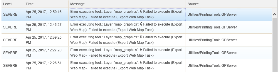

-> Error: Unable to complete operation.
-> This will probably manifest on the server as an error like this:
9) Now, close the infoWindow only
10) Print the page (PDF), which should complete successfully (it does not hit the proxy)

-> Here's a BC difference between the last two requests:
This looks like a genuine bug to me! Any ideas?

ChrisSmith7
Honored Contributor
Just a follow-up, I am working around this by hiding the infoWindow before the export initiates, then showing after modifying ioArgs within Esri request (which I needed to do for my other issue - https://community.esri.com/thread/193761-arcgis-jsapi-printvalidation-issue-syntaxerror-unexpected-t... ). This looks similar to how infoWindow is handled for map services, when rendered during print exec.
I'm going to mark this as "assumed answered" for now, but I notified Esri of the bug.
