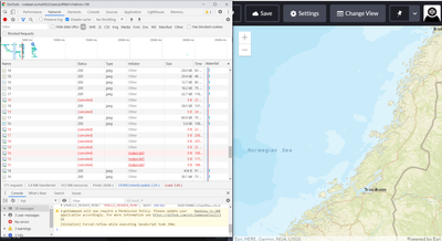

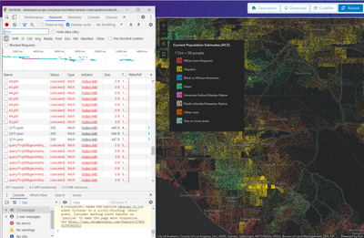

Hmm, if you take a look at https://developers.arcgis.com/javascript/latest/sample-code/sandbox/index.html?sample=visualization-... I can see requests being canceled both for VectorTileLayers (the basemap in this case) and FeatureLayers (the dot density layer):
If I switch the basemap to an TileLayer (non-vector) I can also see cancellation:

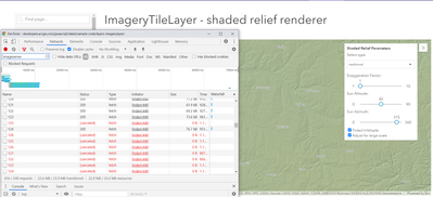

For an ImageryTileLayer though I think I see what you are talking about. Some requests do still get cancelled, but it looks like less requests are getting cancelled than should be.
Imagery tile layer does a lot of processing on the client and is quite expensive at the moment... I imagine what's happening here is the processing is blocked on something which might be causing requests not to get cancelled when they should. It could also be that the abort controlled isn't hooked up properly for this layer type. I'll make an internal issue to see if we see what's going on here.
