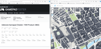

I have attached an animation to demonstrate that the controller is recognised by the browser via the tester.
