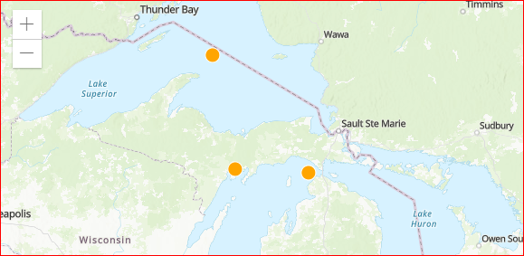

The application displays a topographical  map in an Angular dialog window. The user may add/delete marker symbols on the map using a left mouse-click. The user may also move the marker symbol by left mouse-click on the marker symbol and dragging the marker symbol.
My Question has to do with the dragging behavior. It's choppy and easily lost if the user moves too fast.
